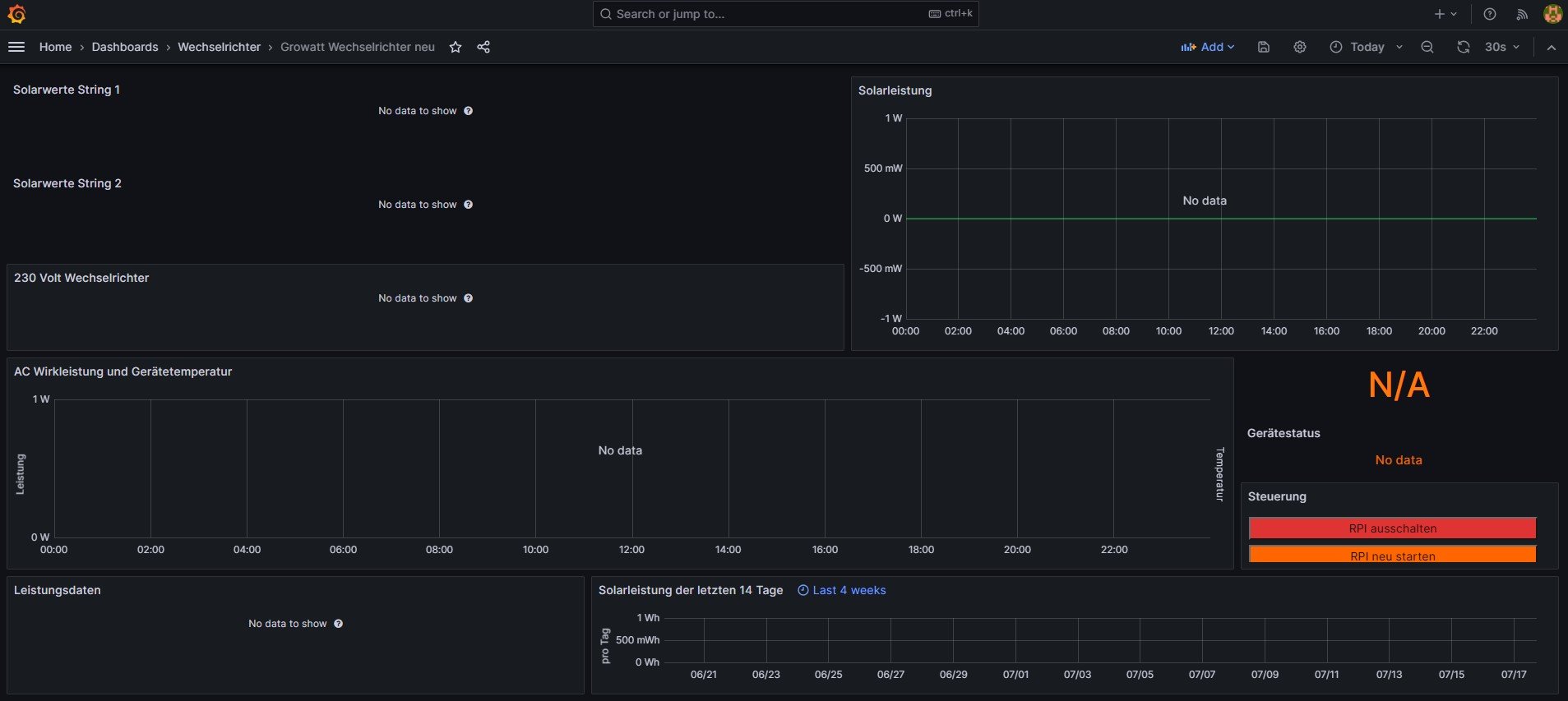

pi@solaranzeige:~ $ hwinfo --usb
18: USB 00.0: 0000 Unclassified device
[Created at usb.122]
Unique ID: BobO.GPdhqcWAsQC
Parent ID: ADDn.IKhPgutgmvF
SysFS ID: /devices/platform/soc/3f980000.usb/usb1/1-1/1-1.2/1-1.2:1.0
SysFS BusID: 1-1.2:1.0
Hardware Class: unknown
Model: "Exar XR21V1410 USB-UART IC"
Hotplug: USB
Vendor: usb 0x04e2 "Exar Corp."
Device: usb 0x1410 "XR21V1410 USB-UART IC"
Revision: "0.03"
Driver: "cdc_acm"
Driver Modules: "cdc_acm"
Speed: 12 Mbps
Module Alias: "usb:v04E2p1410d0003dcEFdsc02dp01ic02isc02ip01in00"
Driver Info #0:
Driver Status: cdc_acm is active
Driver Activation Cmd: "modprobe cdc_acm"
Attached to: #22 (Hub)
pi@solaranzeige:~ $ lsusb
Bus 001 Device 004: ID 04e2:1410 Exar Corp. XR21V1410 USB-UART IC
Bus 001 Device 003: ID 0424:ec00 Microchip Technology, Inc. (formerly SMSC) SMSC9512/9514 Fast Ethernet Adapter
Bus 001 Device 002: ID 0424:9514 Microchip Technology, Inc. (formerly SMSC) SMC9514 Hub

hello, my inverter (SPF3500ES) fails to provide data can anyone help me understand why?

this is the user.config.php file:
$Regler = "48";
$GeraeteNummer = "1";
$Seriennummer = "0000000000";
$Zugang_Kennwort = "";
$HF2211 = false;
$Batteriepacks = "1";
$PylonTech = "2000";
$WR_IP = "0.0.0.0";
$WR_Port = "12345";
$WR_Adresse = "1";
$Objekt = "Casetta";
$InfluxDB_local = true;
$InfluxDBLokal = "solaranzeige";
$Wiederholungen = 1;
$InfluxDB_remote = false;
$InfluxPort = 8086;
$InfluxDBName = "solaranzeige";
$InfluxAdresse = "localhost";
$InfluxSSL = false;
$InfluxUser = "";
$InfluxPassword ="";
$InfluxDaylight = false;
$Homematic = false;
$HomeMaticVar = "";
$HM_auslesen = false;
$HM_Geraetetyp[1] = "";
$HM_Seriennummer[1] = "";
$MQTT = true;
$MQTTBroker = "localhost";
$MQTTPort = 1883;
$MQTTBenutzer = "";
$MQTTKennwort = "";
$MQTTSSL = false;
$MQTTKeepAlive = 60;
$MQTTGeraet = "box1";
$MQTTAuswahl = "";
$Topic = "sonoff";
$Wetterdaten = false;
$APPID = "";
$StandortID = "2925533";
$Prognosedaten = "keine";
$AccessToken = "";
$PrognoseItem = "inverter";
$PrognoseID = "0";
$Algorithmus = "";
$Messenger = false;
$Messengerdienst[1] = "Pushover";
$API_Token[1] = " ";
$User_Key[1] = "";
$Breitengrad = 41.689829;
$Laengengrad = 13.581483;
$aWATTar = false;
$Aufschlag = "0";
$aWATTarLand = "DE";
$USBRegler = "/dev/ttyACM0";
$USBDevice = "004";
$Platine = "Raspberry Pi 2 Model B Rev 1.1";
$Alpha_ESS = 0;
