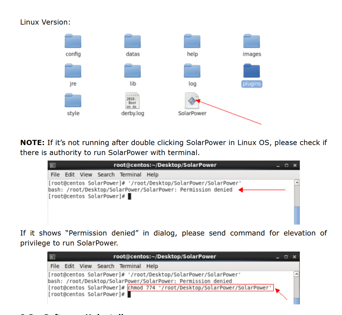

Auszug aus dem manual "solarpowermanual.pdf"
2. SolarPower Install and Uninstall
2.1 System Requirement
 512 MB physical memory at least (1 GB is recommended)
 2GB hard disk space at least
 Administrator authority is required
 More than 32-bit colors and 1280 x 800 or above resolution display is
recommended
 An available communication port is needed
 Platforms supported by software are listed below:
 Windows 2003/2008/XP/Vista/7/8/10 (32bit &x64bit)
 RedHat Linux 8,9
 Linux RedHat Enterprise AS3, AS5, AS6(32bit &64bit)
 Linux SUSE 10 (32bit &64bit)
 Linux Cent OS 5.4 (32bit &64bit)
 Ubuntu 8.x,9.x,10.x (32bit &64bit)
 Linux Fedora 5
 Linux OpenSUSE 11.2 (32bit &64bit)
 Linux Debian 5.x, 6.x (32bit &64bit)
 Mac OS 10.x(x64bit)
Linux Version:
NOTE: If it’s not running after double clicking SolarPower in Linux OS, please check if
there is authority to run SolarPower with terminal.
If it shows “Permission denied” in dialog, please send command for elevation of
privilege to run SolarPower.
