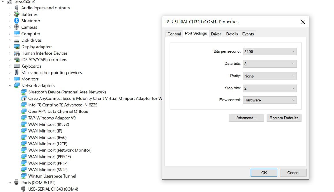

Re: Powmr POW HVM5.5K-48V Hybrid Wechselrichter
mhinz hat geschrieben: ↑Do 12. Jan 2023, 11:34Hi, Martin !
I'm trying to retry your connection using the WiFi Pro Datalogger and all port settings.
I expect that in the Terminal Software (Hyper terminal) 2 times per second I will receive the data set that you mentioned.
Unfortunately this does not come through.
Is everything I repeated correctly?
(Next, I will process data packet by ESP32 and send it to Zabbix & Grafana)
Photos in attachents.
Regards, Alexey,
Ukraine, Kyiv
