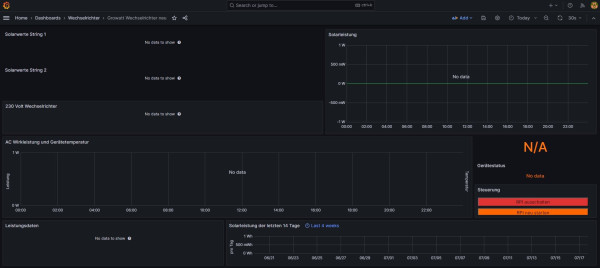

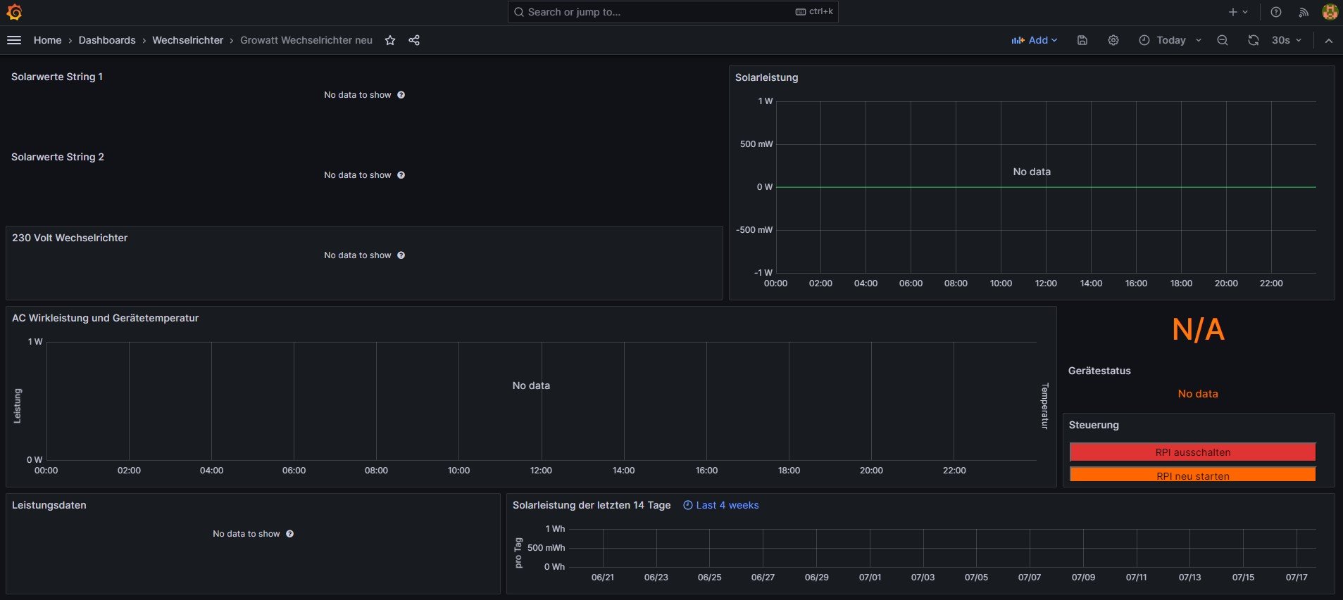

hello, my inverter (SPF3500ES) fails to provide data can anyone help me understand why?
