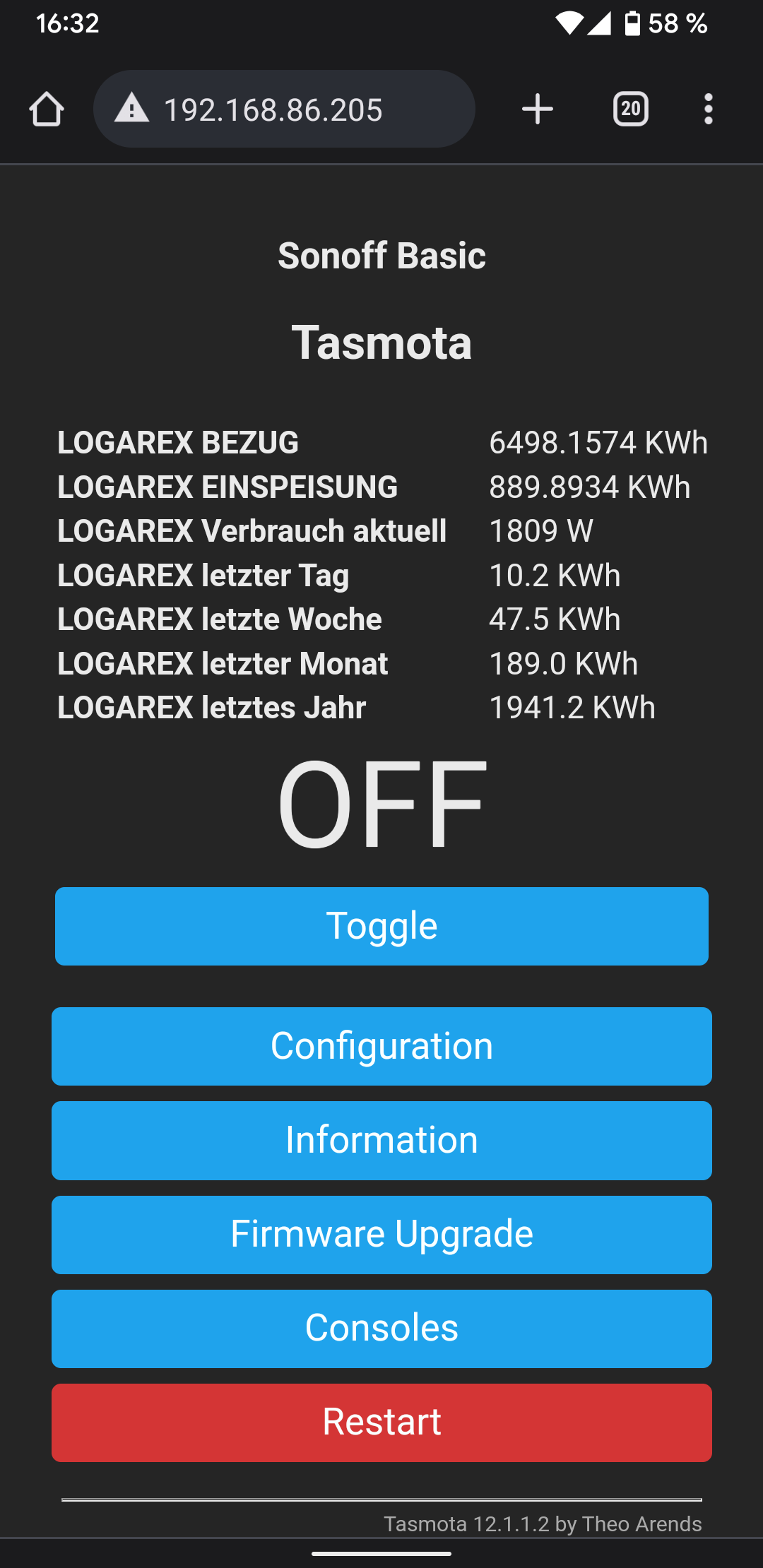

karl-kette
Beiträge: 10
Registriert: So 15. Jan 2023, 13:36
Hat sich bedankt: 5 Mal
Re: Zähler LOGAREX mit Tasmota Lesekopf
Beitrag von karl-kette »
Hallo Timo,
ist es das was Du suchst?
15:34:16.022 CMD: Status 0
15:34:16.028 RSL: STATUS = {"Status":{"Module":1,"DeviceName":"Tasmota","FriendlyName":["Tasmota"],"Topic":"sonoff","ButtonTopic":"0","Power":0,"PowerOnState":3,"LedState":1,"LedMask":"FFFF","SaveData":1,"SaveState":1,"SwitchTopic":"0","SwitchMode":[0,0,0,0,0,0,0,0],"ButtonRetain":0,"SwitchRetain":0,"SensorRetain":0,"PowerRetain":0,"InfoRetain":0,"StateRetain":0,"StatusRetain":0}}
15:34:16.033 RSL: STATUS1 = {"StatusPRM":{"Baudrate":9600,"SerialConfig":"8N1","GroupTopic":"tasmotas","OtaUrl":"http://ota.tasmota.com/tasmota/release/tasmota.bin.gz","RestartReason":"Software/System restart","Uptime":"0T21:21:02","StartupUTC":"2023-01-18T17:13:14","Sleep":50,"CfgHolder":4617,"BootCount":6,"BCResetTime":"2023-01-04T20:06:29","SaveCount":20,"SaveAddress":"F8000"}}
15:34:16.038 RSL: STATUS2 = {"StatusFWR":{"Version":"12.1.1.2(tasmota)","BuildDateTime":"2022-09-18T19:08:29","Boot":31,"Core":"2_7_4_9","SDK":"2.2.2-dev(38a443e)","CpuFrequency":80,"Hardware":"ESP8266EX","CR":"370/699"}}
15:34:16.042 RSL: STATUS3 = {"StatusLOG":{"SerialLog":0,"WebLog":2,"MqttLog":0,"SysLog":0,"LogHost":"","LogPort":514,"SSId":["superpowernetz_2",""],"TelePeriod":300,"Resolution":"558180C0","SetOption":["00008009","2805C80001000600003C5A0A192800000000","00000080","00006000","00004000","00000000"]}}
15:34:16.052 RSL: STATUS4 = {"StatusMEM":{"ProgramSize":659,"Free":344,"Heap":20,"ProgramFlashSize":1024,"FlashSize":1024,"FlashChipId":"1440EF","FlashFrequency":40,"FlashMode":"DOUT","Features":["00000809","879AC787","043E8001","000000CF","010013C0","C000F989","00004004","00001000","54000020","00000000"],"Drivers":"1,2,3,4,5,6,7,8,9,10,12,16,18,19,20,21,22,24,26,27,29,30,35,37,45,62","Sensors":"1,2,3,4,5,6,53"}}
15:34:16.057 RSL: STATUS5 = {"StatusNET":{"Hostname":"sonoff-4156","IPAddress":"192.168.86.205","Gateway":"192.168.86.1","Subnetmask":"255.255.255.0","DNSServer1":"192.168.86.1","DNSServer2":"0.0.0.0","Mac":"84:CC:A8:98:90:3C","Webserver":2,"HTTP_API":1,"WifiConfig":4,"WifiPower":17.0}}
15:34:16.061 RSL: STATUS6 = {"StatusMQT":{"MqttHost":"192.168.86.202","MqttPort":1883,"MqttClientMask":"DVES_%06X","MqttClient":"DVES_98903C","MqttUser":"DVES_USER","MqttCount":15,"MAX_PACKET_SIZE":1200,"KEEPALIVE":30,"SOCKET_TIMEOUT":4}}
15:34:16.067 RSL: STATUS7 = {"StatusTIM":{"UTC":"2023-01-19T14:34:16","Local":"2023-01-19T15:34:16","StartDST":"2023-03-26T02:00:00","EndDST":"2023-10-29T03:00:00","Timezone":"+01:00","Sunrise":"08:35","Sunset":"17:26"}}
15:34:16.075 RSL: STATUS10 = {"StatusSNS":{"Time":"2023-01-19T15:34:16","LOGAREX":{"total_in":6534.6851,"total_out":890.0664,"power_curr":2972,"total_day":3.3,"total_week":47.3,"total_month":183.1,"total_year":1933.8}}}
15:34:16.080 RSL: STATUS11 = {"StatusSTS":{"Time":"2023-01-19T15:34:16","Uptime":"0T21:21:02","UptimeSec":76862,"Heap":20,"SleepMode":"Dynamic","Sleep":50,"LoadAvg":29,"MqttCount":15,"POWER":"OFF","Wifi":{"AP":1,"SSId":"superpowernetz_2","BSSId":"70:3A:CB:77:6A:30","Channel":6,"Mode":"11n","RSSI":36,"Signal":-82,"LinkCount":1,"Downtime":"0T00:00:03"}}}
15:34:16.203 RSL: STATUS10 = {"StatusSNS":{"Time":"2023-01-19T15:34:16","LOGAREX":{"total_in":6534.6851,"total_out":890.0664,"power_curr":2972,"total_day":3.3,"total_week":47.3,"total_month":183.1,"total_year":1933.8}}}
15:34:16.457 RSL: SENSOR = {"Time":"2023-01-19T15:34:16","LOGAREX":{"power_curr":2961}}
15:34:16.962 RSL: STATUS10 = {"StatusSNS":{"Time":"2023-01-19T15:34:16","LOGAREX":{"total_in":6534.6867,"total_out":890.0664,"power_curr":2961,"total_day":3.3,"total_week":47.3,"total_month":183.1,"total_year":1933.8}}}
15:34:17.936 RSL: STATUS10 = {"StatusSNS":{"Time":"2023-01-19T15:34:17","LOGAREX":{"total_in":6534.6867,"total_out":890.0664,"power_curr":2961,"total_day":3.3,"total_week":47.3,"total_month":183.1,"total_year":1933.8}}}
15:34:18.431 RSL: SENSOR = {"Time":"2023-01-19T15:34:18","LOGAREX":{"power_curr":2970}}

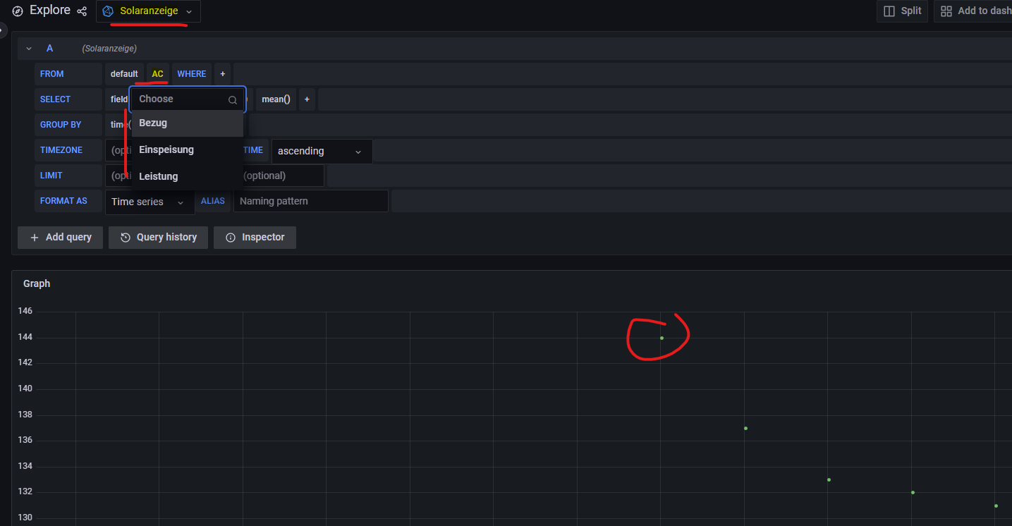

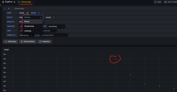

Hallo Timo,
die Faktoren stimmen in den Script nicht, die Werte sind schon in kWh und müssen nicht mit Faktor 1000 mal genommen werden. So müsste es richtig sein:
>D
>B
=>sensor53 r
>M 1
+1,3,o,0,9600,LK13BE
1,1-0:1.8.0*255(@1,Bezug,KWh,total_in,4
1,1-0:2.8.0*255(@1,Einspeisung,KWh,total_out,4
1,1-0:16.7.0*255(@1,Verbrauch aktuell,W,Power,16
1,1-0:1.8.0*96(@1,letzter Tag,KWh,total_1d,1
1,1-0:1.8.0*97(@1,letzte Woche,KWh,total_7d,1
1,1-0:1.8.0*98(@1,letzter Monat,KWh,total_30d,1
1,1-0:1.8.0*99(@1,letztes Jahr,KWh,total_365d,1
Man kann sich auch noch mehr Daten anzeigen lassen. Eine Beschreibung aller möglichen Parameter findest Du hier auf Seite 9 und 10: https://www.stadtwerke-burgdorf-netz.de ... 8030x9.pdf
In der Datenbank kommen nun unter AC folgende measurements, Bezug, Einspeisung und Leistung. Auch under Summen und Statistik gibt es jetzt Werte, die PHP scripte sollte also funktioniert haben. Top!

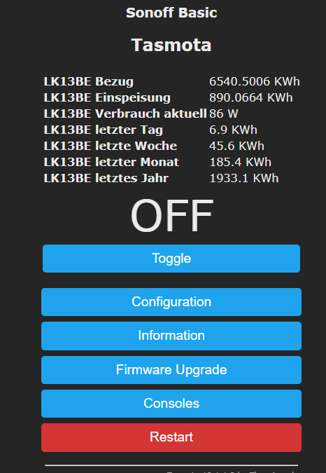

karl-kette
Beiträge: 10

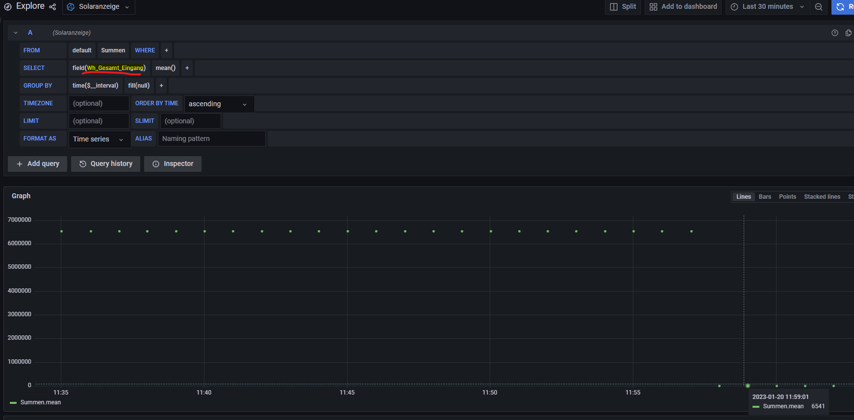

Also bei Faktor 1 erhalten wir kWh, was auch richtig angezeigt wird by Tasmota "LK13BE Bezug 6540.6520 KWh" -> "@1,Bezug,KWh,total_in,4". In der Solaranzeige Datenbank heißen die Felder aber alle mit Wh_..., zb "Wh_Gesamt_Eingang". Dann passt es wieder nicht, dann müsstest Du dochden Wert mal 1000 nehmen um auf Wh zukommen...
