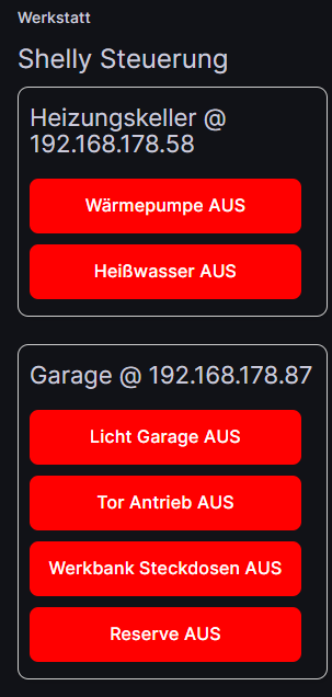

<!DOCTYPE html>
<html>
<head>

  <h2>Shelly Steuerung</h2>
  <div id="devices"></div>
  <script>
    // ===== KONFIGURATION =====
    const devices = [
        ip: "192.168.178.58",
        relays: [
          { id: 0, name: "Wärmepumpe" },
          { id: 1, name: "Heißwasser" }
        ip: "192.168.178.87",
        relays: [
          { id: 0, name: "Licht Garage" },
          { id: 1, name: "Tor Antrieb" },
          { id: 2, name: "Werkbank Steckdosen" },
          { id: 3, name: "Reserve" }
    const devicesDiv = document.getElementById("devices");
    // Buttons pro Gerät erzeugen
    devices.forEach(device => {
      let devDiv = document.createElement("div");
      devDiv.className = "device";
      let title = document.createElement("h3");
      title.innerText = `${device.name} @ ${device.ip}`;
      devDiv.appendChild(title);
      device.relays.forEach(relay => {
        let btn = document.createElement("button");
        btn.id = `relay_${device.ip}_${relay.id}`;
        btn.className = "btn btn-off";
        btn.innerText = relay.name + " AUS";
        btn.onclick = function() {
          fetch(`http://${device.ip}/rpc/switch.toggle?id=${relay.id}`)
            .then(() => setTimeout(() => updateDevice(device), 1000)); // 1 Sek. warten
        devDiv.appendChild(btn);
      devicesDiv.appendChild(devDiv);
    // Status für ein Gerät laden
    async function updateDevice(device) {
      try {
        let res = await fetch(`http://${device.ip}/rpc/Shelly.GetStatus`);
        let data = await res.json();
          let sw = data[`switch:${relay.id}`];
          if (sw && sw.output !== undefined) {
            updateButton(device.ip, relay, sw.output);
      } catch (err) {
        console.error(`Shelly ${device.ip} nicht erreichbar:`, err);
    // Button anpassen
    function updateButton(ip, relay, isOn) {
      let btn = document.getElementById(`relay_${ip}_${relay.id}`);
      if (isOn) {
        btn.className = "btn btn-on";
        btn.innerText = relay.name + " EIN";
      } else {
    // Alle Geräte aktualisieren
    function updateAll() {
      devices.forEach(device => updateDevice(device));
    // Status alle 3 Sekunden abrufen
    setInterval(updateAll, 3000);
    updateAll();
  </script>
</body>
</html>
Und dass kommt nun dabei raus es lässt sich schalten und in der grafana .ini musste
[security]
allow_embedding = true
disable_sanitize_html = true
noch umgesetzt werden.
Leider funktioniert der Staus nicht mal schaun ob mir da gpt weiter helfen kann oder woran es liegt
