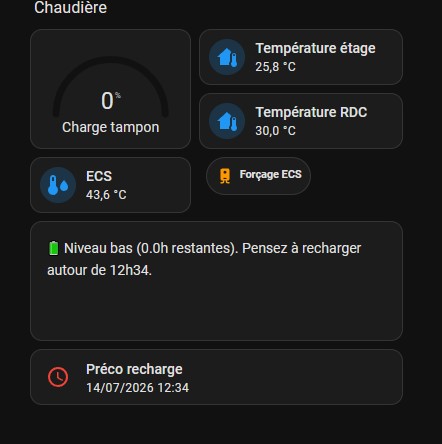

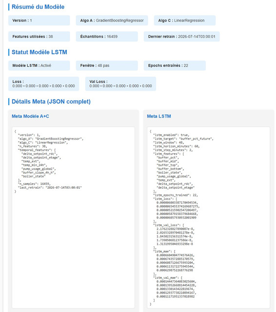

Re: *******Die Schwarzesolaranzeige*******
Impressive, great work!!
I'm French and I also have an ETA SH30, and I've used (and significantly modified) Solaranzeige to get data feeds into Grafana and Home Assistant. Right now I'm working on a prediction and alert system based on deep learning and an LSTM, combining weather data, the heating schedule, and boiler statistics.
On top of that, I've been struggling lately with repeated reading errors, even though nothing has changed. I'd genuinely love to exchange knowledge and compare notes on our current work.
